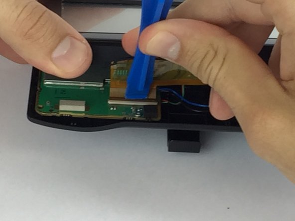

  3. Garmin Nuvi 56LMT Battery Replacement: crwdns2935265:03crwdnd2935265:01crwdnd2935265:03crwdne2935265:0 Garmin Nuvi 56LMT Battery Replacement: crwdns2935265:03crwdnd2935265:02crwdnd2935265:03crwdne2935265:0 Garmin Nuvi 56LMT Battery Replacement: crwdns2935265:03crwdnd2935265:03crwdnd2935265:03crwdne2935265:0
    • Observe the ribbon connecting the screen to the circuit board.
    • Detach the clip using the plastic opening tool and set aside the screen.

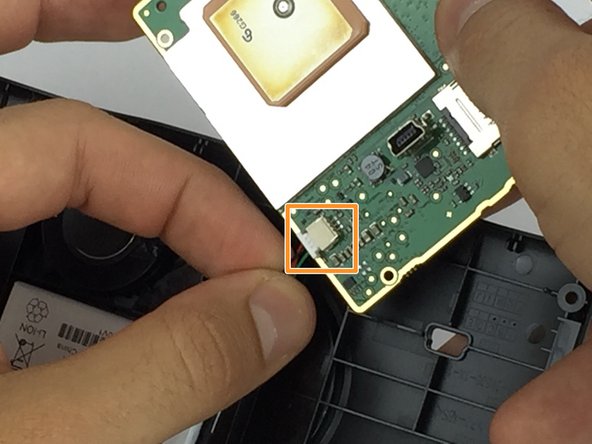

  4. Garmin Nuvi 56LMT Battery Replacement: crwdns2935265:04crwdnd2935265:01crwdnd2935265:03crwdne2935265:0 Garmin Nuvi 56LMT Battery Replacement: crwdns2935265:04crwdnd2935265:02crwdnd2935265:03crwdne2935265:0 Garmin Nuvi 56LMT Battery Replacement: crwdns2935265:04crwdnd2935265:03crwdnd2935265:03crwdne2935265:0
    • Using the T5 Torx screwdriver, remove the two remaining 5.0 mm screws.
    • Lift the board from its housing and then detach the plug coming from the battery.

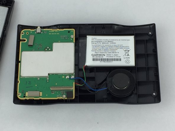

  5. Garmin Nuvi 56LMT Battery Replacement: crwdns2935265:05crwdnd2935265:01crwdnd2935265:01crwdne2935265:0
    • If the battery is glued in place use the plastic opening tool to remove it.
    • Finally, exchange the old battery with the replacement.
