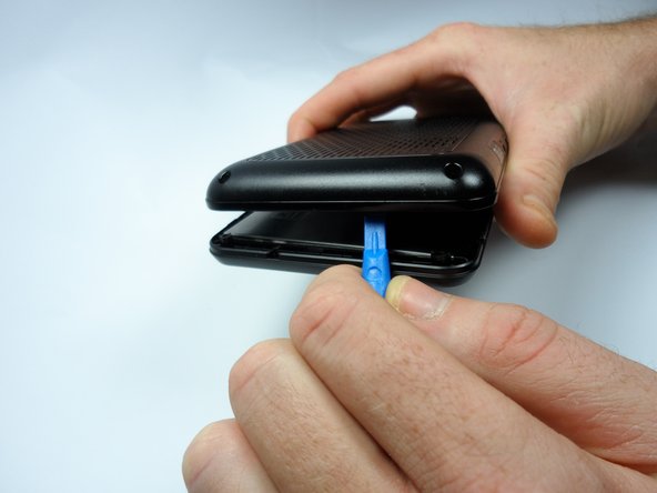

  3. Garmin Nuvi 50LM Speaker Replacement: crwdns2935265:03crwdnd2935265:01crwdnd2935265:03crwdne2935265:0 Garmin Nuvi 50LM Speaker Replacement: crwdns2935265:03crwdnd2935265:02crwdnd2935265:03crwdne2935265:0 Garmin Nuvi 50LM Speaker Replacement: crwdns2935265:03crwdnd2935265:03crwdnd2935265:03crwdne2935265:0
    • Gently pry open the device with the iFixit Plastic Opening Tool found in the iFixit Pro Tech Tool Kit.
    • Be careful not to damage the orange ribbon cable and the motherboard.

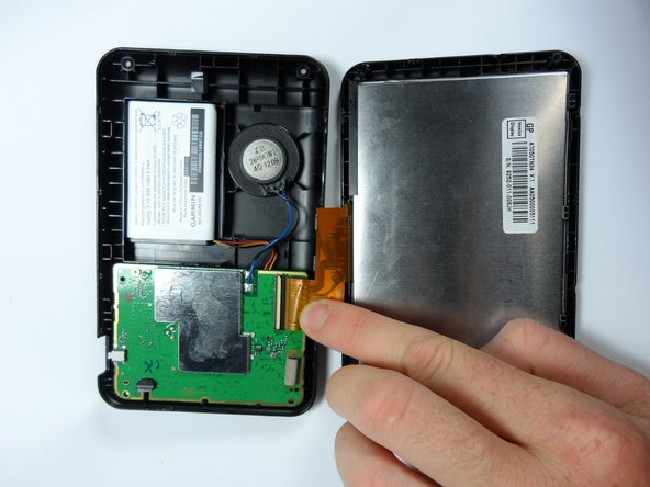

  4. Garmin Nuvi 50LM Speaker Replacement: crwdns2935265:04crwdnd2935265:01crwdnd2935265:03crwdne2935265:0 Garmin Nuvi 50LM Speaker Replacement: crwdns2935265:04crwdnd2935265:02crwdnd2935265:03crwdne2935265:0 Garmin Nuvi 50LM Speaker Replacement: crwdns2935265:04crwdnd2935265:03crwdnd2935265:03crwdne2935265:0
    • Once the GPS is open, identify the black and blue wires connecting the black speaker to the green motherboard.
    • The black wire is located closest to the speaker.
    • The blue wire is located farthest from the speaker.
