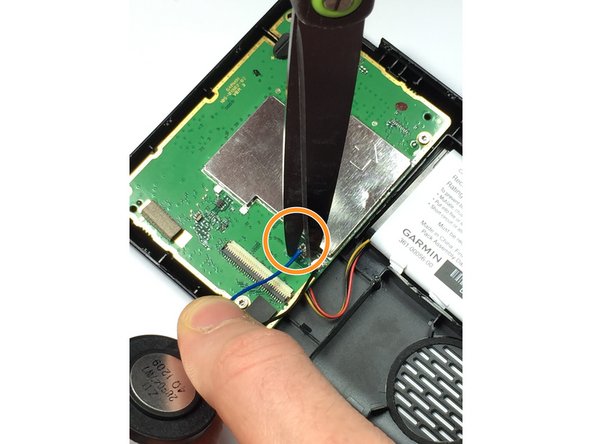

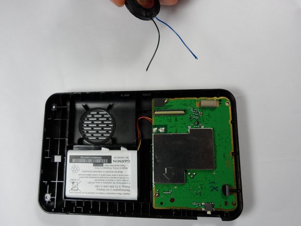

    • Use a pair of wire cutters to cut and separate the black speaker wire from the motherboard.
    • Use a pair of wire cutters to cut and separate the blue speaker wire from the motherboard.
    • To reattach the new speaker, you must use a soldering iron to solder the speaker cables to the motherboard.

    • Place the replacement motherboard in the navigation system, and solder the speaker cables on the replacement motherboard.
    • Solder the black wire to the motherboard.
    • Solder the blue wire to the motherboard.
    • The soldering iron is extremely hot, so use prudence when working with the soldering iron.
    • The black speaker wire is the wire closest to the battery.
