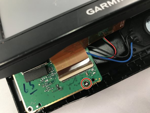

    1. Garmin Nuvi 42LM USB Replacement, USB: crwdns2935265:03crwdnd2935265:01crwdnd2935265:03crwdne2935265:0 Garmin Nuvi 42LM USB Replacement, USB: crwdns2935265:03crwdnd2935265:02crwdnd2935265:03crwdne2935265:0 Garmin Nuvi 42LM USB Replacement, USB: crwdns2935265:03crwdnd2935265:03crwdnd2935265:03crwdne2935265:0
      • Using the T5 Torx screwdriver, remove the two screws located on the motherboard.
      • There are two screws - one in the front and one in the back of the motherboard.
    2. Garmin Nuvi 42LM USB Replacement: crwdns2935265:04crwdnd2935265:01crwdnd2935265:01crwdne2935265:0
      • Move the motherboard from from its designated location on the GPS.
      • Do not pull on red, green, blue and black cables when repositioning the motherboard.
