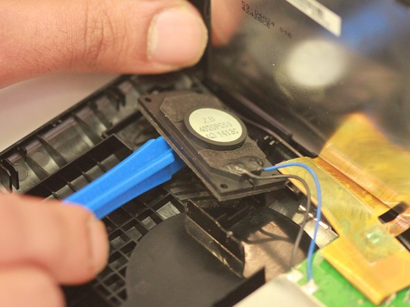

  3. Garmin Nuvi 42LM Speaker Replacement, Speaker: crwdns2935265:03crwdnd2935265:01crwdnd2935265:02crwdne2935265:0 Garmin Nuvi 42LM Speaker Replacement, Speaker: crwdns2935265:03crwdnd2935265:02crwdnd2935265:02crwdne2935265:0
    • Use the plastic opening tool to pry the speaker away from the device.
    • Be gentle, the speakers are connected to the motherboard by blue and black wire.
