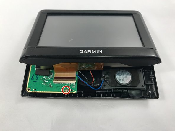

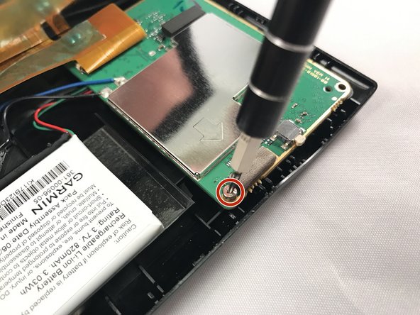

    1. Garmin Nuvi 42LM Screen Replacement, Motherboard: crwdns2935265:03crwdnd2935265:01crwdnd2935265:03crwdne2935265:0 Garmin Nuvi 42LM Screen Replacement, Motherboard: crwdns2935265:03crwdnd2935265:02crwdnd2935265:03crwdne2935265:0 Garmin Nuvi 42LM Screen Replacement, Motherboard: crwdns2935265:03crwdnd2935265:03crwdnd2935265:03crwdne2935265:0
      • Using the T5 Torx screwdriver, remove the two screws located on the motherboard.
      • There are two screws - one in the back and one in the front.

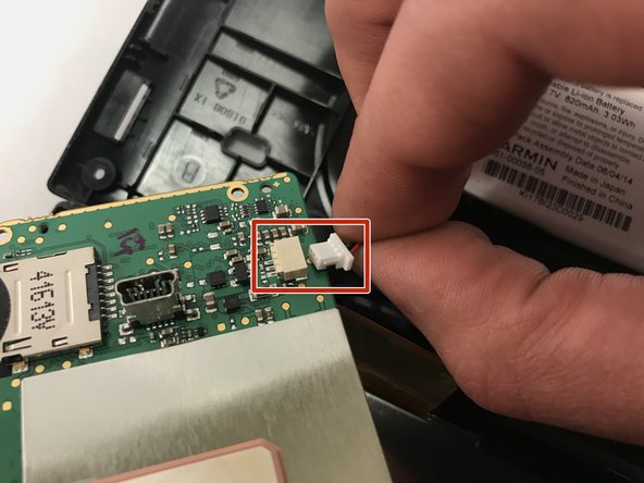

    3. Garmin Nuvi 42LM Screen Replacement: crwdns2935265:05crwdnd2935265:01crwdnd2935265:02crwdne2935265:0 Garmin Nuvi 42LM Screen Replacement: crwdns2935265:05crwdnd2935265:02crwdnd2935265:02crwdne2935265:0
      • Gently unplug the red, green, and black bundled cable to remove the battery.

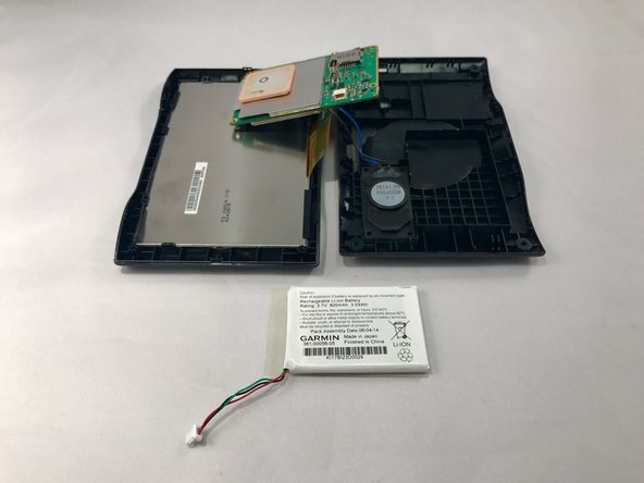

    4. Garmin Nuvi 42LM Screen Replacement: crwdns2935265:06crwdnd2935265:01crwdnd2935265:02crwdne2935265:0 Garmin Nuvi 42LM Screen Replacement: crwdns2935265:06crwdnd2935265:02crwdnd2935265:02crwdne2935265:0
      • Use blue plastic opening tool to carefully pry the battery from the GPS.
      • You might need to use additional force when prying because there is adhesive glue on the back of the battery.
    5. Garmin Nuvi 42LM Screen Replacement: crwdns2935265:07crwdnd2935265:01crwdnd2935265:01crwdne2935265:0
      • Using a soldering iron, desolder the black and blue wires connected to the motherboard.
      • Once the black and blue wires are desoldered, llift the motherboard out and away from the device.

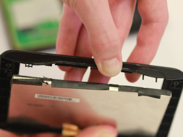

    1. Garmin Nuvi 42LM Screen Replacement, Screen: crwdns2935265:08crwdnd2935265:01crwdnd2935265:02crwdne2935265:0 Garmin Nuvi 42LM Screen Replacement, Screen: crwdns2935265:08crwdnd2935265:02crwdnd2935265:02crwdne2935265:0
      • Push out the screen by pulling back the black clips.
      • The screen is attached to the motherboard and needs to be replaced with it.
