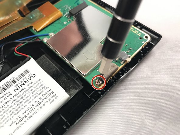

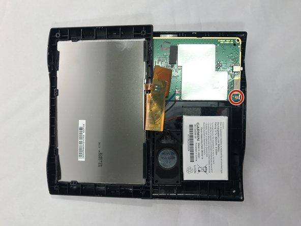

      • Using the T5 Torx screwdriver, remove the two screws located on the motherboard.
      • There are two screws - one in the back and one in the front.

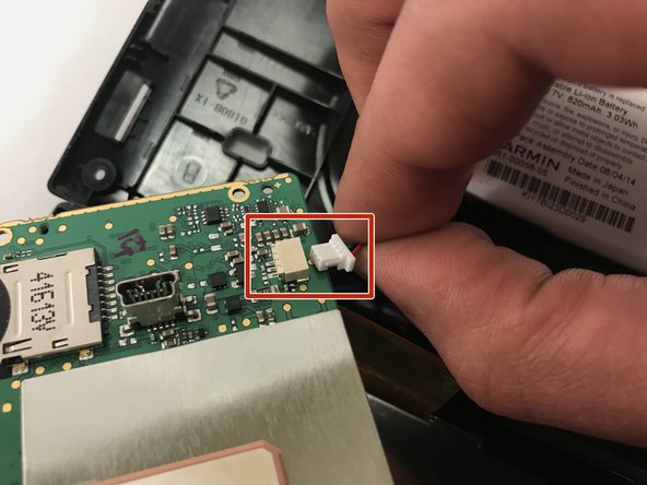

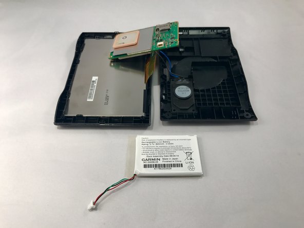

      • Gently unplug the red, green, and black bundled cable to remove the battery.
    6. Garmin Nuvi 42LM Battery Replacement: crwdns2935265:06crwdnd2935265:01crwdnd2935265:02crwdne2935265:0 Garmin Nuvi 42LM Battery Replacement: crwdns2935265:06crwdnd2935265:02crwdnd2935265:02crwdne2935265:0
      • Use blue plastic opening tool to carefully pry the battery from the GPS.
      • You might need to use additional force when prying because there is adhesive glue on the back of the battery.
