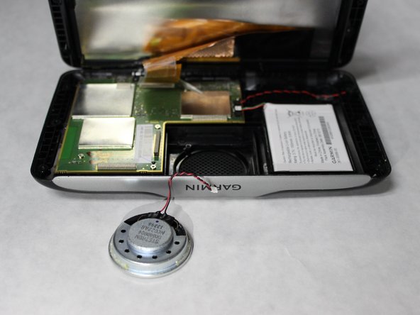

    • Before you begin make sure to turn off your GPS.
    • Using your T-6 Torx Screwdriver, unscrew the ten 2.38 mm torx T-6 screws from the back of your GPS.
  2. Garmin Nuvi 2797LMT Speaker  Replacement: crwdns2935265:02crwdnd2935265:01crwdnd2935265:03crwdne2935265:0 Garmin Nuvi 2797LMT Speaker  Replacement: crwdns2935265:02crwdnd2935265:02crwdnd2935265:03crwdne2935265:0 Garmin Nuvi 2797LMT Speaker  Replacement: crwdns2935265:02crwdnd2935265:03crwdnd2935265:03crwdne2935265:0
    • Using the biggest plastic opening tool, pry open the GPS from the sides. You should now be able to see everything inside the GPS.
    • Be careful when opening the GPS because of the ribbon attached to the screen. It can tear easily.
  3. Garmin Nuvi 2797LMT Speaker  Replacement: crwdns2935265:03crwdnd2935265:01crwdnd2935265:01crwdne2935265:0
    • Locate the speaker's wire connector plugged into the motherboard. Now delicately detach the speaker connector by pulling directly up.
  4. Garmin Nuvi 2797LMT Speaker  Replacement: crwdns2935265:04crwdnd2935265:01crwdnd2935265:01crwdne2935265:0
    • Now using the nylon or metal spudger, carefully pry the glue away from the sides of the speaker.
    • The speaker has been attached with strong glue so you will need to use a little bit of force when prying it out. Also be careful while using the nylon or metal spudger so you don't get hurt and the device doesn't get damaged.
  5. Garmin Nuvi 2797LMT Speaker  Replacement: crwdns2935265:05crwdnd2935265:01crwdnd2935265:02crwdne2935265:0 Garmin Nuvi 2797LMT Speaker  Replacement: crwdns2935265:05crwdnd2935265:02crwdnd2935265:02crwdne2935265:0
    • Now using the plastic opening tool, pry the speaker up from one of the sides. Your speaker will completely come out of the device.
