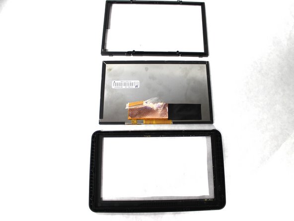

    • Now pulling up on one of the corners, bring the top half of the casing out of the bottom half.
  6. Garmin Nuvi 2797LMT LCD Screen Replacement: crwdns2935265:06crwdnd2935265:01crwdnd2935265:02crwdne2935265:0 Garmin Nuvi 2797LMT LCD Screen Replacement: crwdns2935265:06crwdnd2935265:02crwdnd2935265:02crwdne2935265:0
    • Now remove the front casing and back casing away from the screen. You will end up with three separate pieces.
