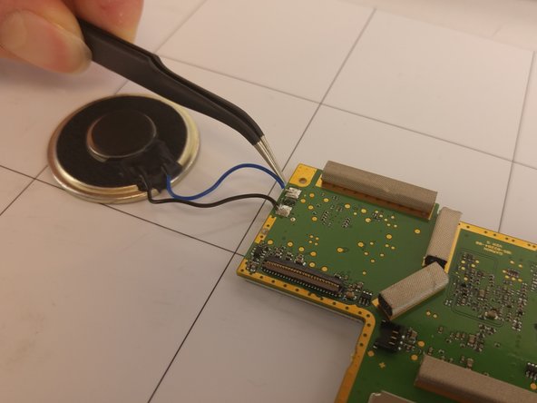

  11. Garmin Nuvi 2689LMT Speaker Replacement, Speaker: crwdns2935265:011crwdnd2935265:01crwdnd2935265:01crwdne2935265:0
    • Tape the main circuit board onto a clean surface to steady the device.
  12. Garmin Nuvi 2689LMT Speaker Replacement: crwdns2935265:012crwdnd2935265:01crwdnd2935265:02crwdne2935265:0 Garmin Nuvi 2689LMT Speaker Replacement: crwdns2935265:012crwdnd2935265:02crwdnd2935265:02crwdne2935265:0
    • Melt and separate the the two metal connections on the circuit using a soldering iron then remove the wires using tweezers.
    • Soldering irons will reach extremely high temperatures and should be used with caution.
  13. Garmin Nuvi 2689LMT Speaker Replacement: crwdns2935265:013crwdnd2935265:01crwdnd2935265:01crwdne2935265:0
    • Retrieve your replacement speaker and re-solder the wires back onto the main circuit board.
    • Try to keep the solder on the metal contact points. Avoid heating the plastic circuit board.
