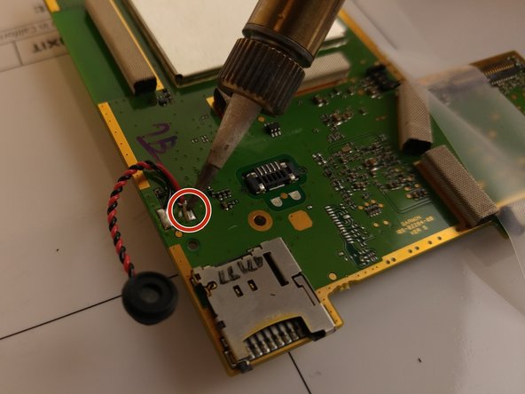

  7. Garmin Nuvi 2689LMT Microphone Replacement: crwdns2935265:07crwdnd2935265:01crwdnd2935265:02crwdne2935265:0 Garmin Nuvi 2689LMT Microphone Replacement: crwdns2935265:07crwdnd2935265:02crwdnd2935265:02crwdne2935265:0
    • Melt the two metal connections on the circuit board using a soldering iron.
    • Remove the wires using tweezers.
    • There are two wires that are connected to the main circuit board.
    • Soldering irons will reach extremely high temperatures and should be used with caution.
  8. Garmin Nuvi 2689LMT Microphone Replacement: crwdns2935265:08crwdnd2935265:01crwdnd2935265:01crwdne2935265:0
    • Retrieve your new microphone for your Garmin device and attach to the circuit board with the soldering iron.
    • Carefully melt the solder onto the wire at the connection points on circuit board.
    • Keep the solder on the metal contact point and avoid heating the plastic circuit board to prevent damage.
