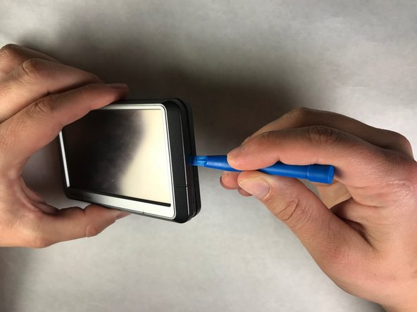

  3. Garmin Nuvi 260W Circuit Board Replacement: crwdns2935265:03crwdnd2935265:01crwdnd2935265:02crwdne2935265:0 Garmin Nuvi 260W Circuit Board Replacement: crwdns2935265:03crwdnd2935265:02crwdnd2935265:02crwdne2935265:0
    • Once screws are removed, use the plastic opening tool to carefully separate the body from the screen encasing.
