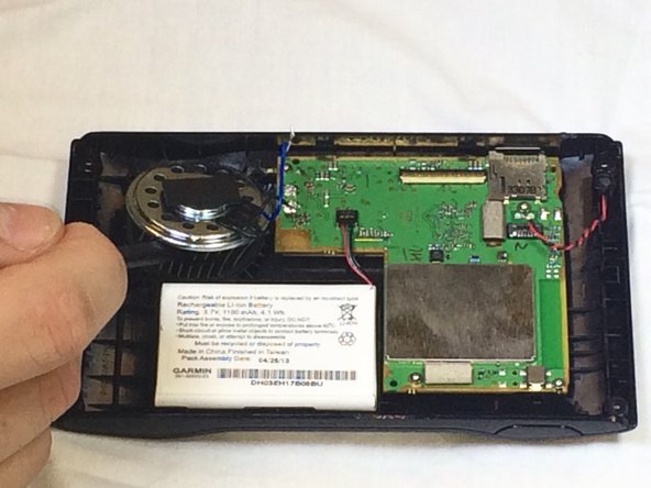

    • Turn your device over so the back is revealed and you can see the screws in the four corners.
    • Remove the four 3mm width by 6mm length T5 Torx screws using your screwdriver.
  2. Garmin Nuvi 2597LMT Speaker Replacement: crwdns2935265:02crwdnd2935265:01crwdnd2935265:03crwdne2935265:0 Garmin Nuvi 2597LMT Speaker Replacement: crwdns2935265:02crwdnd2935265:02crwdnd2935265:03crwdne2935265:0 Garmin Nuvi 2597LMT Speaker Replacement: crwdns2935265:02crwdnd2935265:03crwdnd2935265:03crwdne2935265:0
    • Use the plastic opening tool to pry open the device at the seam where the two halves meet, prying all along all sides if need be.
    • Do it slowly so you don't accidently rip the ribbon cable that connects the digitizer to the motherboard, as well as don't completely separate the halves as this can tear the ribbon cable.
    • Open your device from the top, so that you don't disconnect the ribbon cable.
  3. Garmin Nuvi 2597LMT Speaker Replacement: crwdns2935265:03crwdnd2935265:01crwdnd2935265:02crwdne2935265:0 Garmin Nuvi 2597LMT Speaker Replacement: crwdns2935265:03crwdnd2935265:02crwdnd2935265:02crwdne2935265:0
    • Use your thin spudger to gently lift the speaker off of the sticky pad and away from the casing.

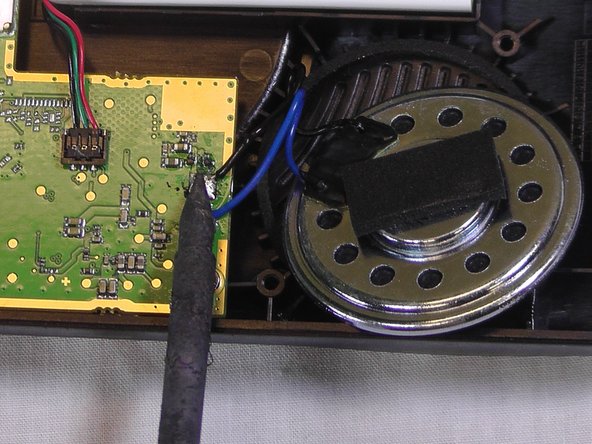

  4. Garmin Nuvi 2597LMT Speaker Replacement: crwdns2935265:04crwdnd2935265:01crwdnd2935265:02crwdne2935265:0 Garmin Nuvi 2597LMT Speaker Replacement: crwdns2935265:04crwdnd2935265:02crwdnd2935265:02crwdne2935265:0
    • Use your soldering iron to disconnect the wires from the motherboard. Disconnect the ground wire (the black one) and the positive wire (the blue one).
    • The soldering iron is very hot and do not touch the wires to anything as it may stick to it when it cools.
    • After you have finished this step and the wire ends have cooled, you can safely set the removed speaker aside.
