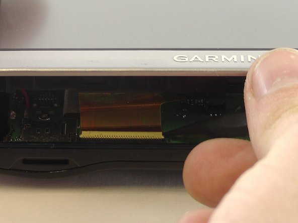

  2. Garmin Nuvi 2597LMT Motherboard Replacement: crwdns2935265:02crwdnd2935265:01crwdnd2935265:03crwdne2935265:0 Garmin Nuvi 2597LMT Motherboard Replacement: crwdns2935265:02crwdnd2935265:02crwdnd2935265:03crwdne2935265:0 Garmin Nuvi 2597LMT Motherboard Replacement: crwdns2935265:02crwdnd2935265:03crwdnd2935265:03crwdne2935265:0
    • Use the plastic opening tool to pry open the device at the seam where the two halves meet, prying all along the sides and the top seams if need be.
    • Do it slowly so you don't accidently rip the ribbon cable that connects the digitizer to the motherboard, as well as don't completely separate the halves as this can tear the ribbon cable.

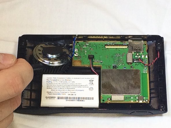

  3. Garmin Nuvi 2597LMT Motherboard Replacement: crwdns2935265:03crwdnd2935265:01crwdnd2935265:02crwdne2935265:0 Garmin Nuvi 2597LMT Motherboard Replacement: crwdns2935265:03crwdnd2935265:02crwdnd2935265:02crwdne2935265:0
    • Locate the battery and then use your spudger to gently lift the battery, which is held to the case using a sticky pad, and free it from its position.
    • When you remove the battery, do so slowly so that the wires connecting it to the motherboard aren't torn. The wires will be disconnected in the next step.

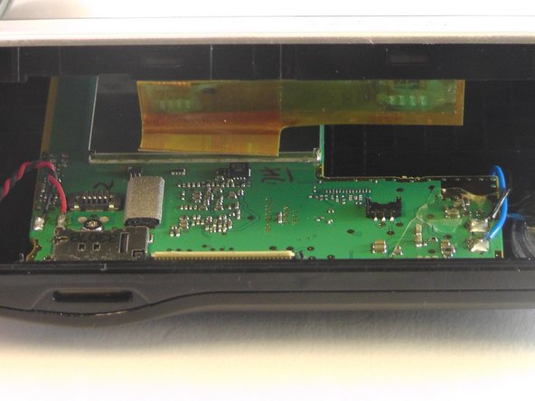

  5. Garmin Nuvi 2597LMT Motherboard Replacement, Motherboard: crwdns2935265:05crwdnd2935265:01crwdnd2935265:03crwdne2935265:0 Garmin Nuvi 2597LMT Motherboard Replacement, Motherboard: crwdns2935265:05crwdnd2935265:02crwdnd2935265:03crwdne2935265:0 Garmin Nuvi 2597LMT Motherboard Replacement, Motherboard: crwdns2935265:05crwdnd2935265:03crwdnd2935265:03crwdne2935265:0
    • Use your tweezers to flip back the tab of the ZIF (Zero Insertion Force) Connector, that is used to keep the ribbon cable in place.
    • This releases the ribbon cable separating the two halves of the device.

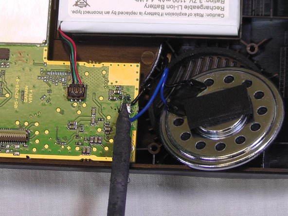

  7. Garmin Nuvi 2597LMT Motherboard Replacement: crwdns2935265:07crwdnd2935265:01crwdnd2935265:02crwdne2935265:0 Garmin Nuvi 2597LMT Motherboard Replacement: crwdns2935265:07crwdnd2935265:02crwdnd2935265:02crwdne2935265:0
    • Use your soldering iron to disconnect the wires from the motherboard. Disconnect the ground wire (the black one) and the positive wire (the blue one).
    • The soldering iron is very hot and do not touch the wires to anything as it may stick to it when it cools.
    • After you have finished this step and the wire ends have cooled, you can safely set the removed speaker aside.

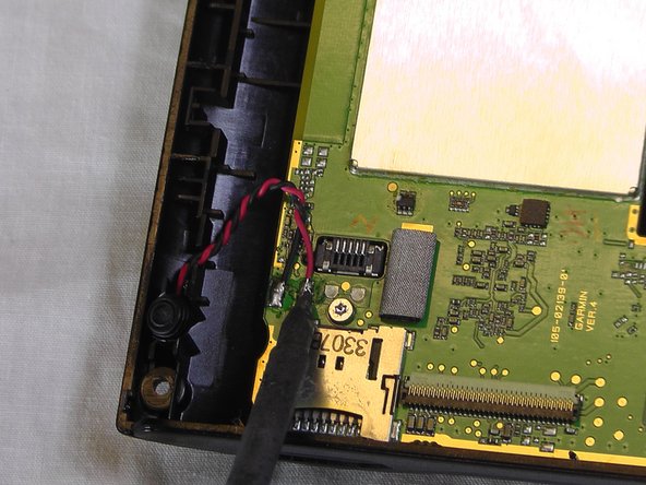

  8. Garmin Nuvi 2597LMT Motherboard Replacement: crwdns2935265:08crwdnd2935265:01crwdnd2935265:02crwdne2935265:0 Garmin Nuvi 2597LMT Motherboard Replacement: crwdns2935265:08crwdnd2935265:02crwdnd2935265:02crwdne2935265:0
    • Use your soldering iron to disconnect the wires from the motherboard. Disconnect the ground wire (the black one) and the positive wire (the red one).

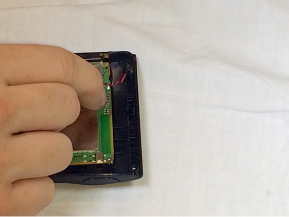

  9. Garmin Nuvi 2597LMT Motherboard Replacement: crwdns2935265:09crwdnd2935265:01crwdnd2935265:02crwdne2935265:0 Garmin Nuvi 2597LMT Motherboard Replacement: crwdns2935265:09crwdnd2935265:02crwdnd2935265:02crwdne2935265:0
    • Use your hands to gently pull the microphone up and out of the casing.
    • After this step is complete, you can safely set the removed microphone aside.

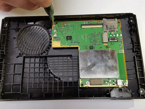

  10. Garmin Nuvi 2597LMT Motherboard Replacement: crwdns2935265:010crwdnd2935265:01crwdnd2935265:02crwdne2935265:0 Garmin Nuvi 2597LMT Motherboard Replacement: crwdns2935265:010crwdnd2935265:02crwdnd2935265:02crwdne2935265:0
    • Remove the four 4mm width by 5mm length T5 Torx screws using your screwdriver.
  11. Garmin Nuvi 2597LMT Motherboard Replacement: crwdns2935265:011crwdnd2935265:01crwdnd2935265:01crwdne2935265:0
    • Use your spudger to gently lift the motherboard out, it just sits in there so you don't have to struggle to get it out.
    • After this step, you can safely set your motherboard aside since it is out of the casing.
