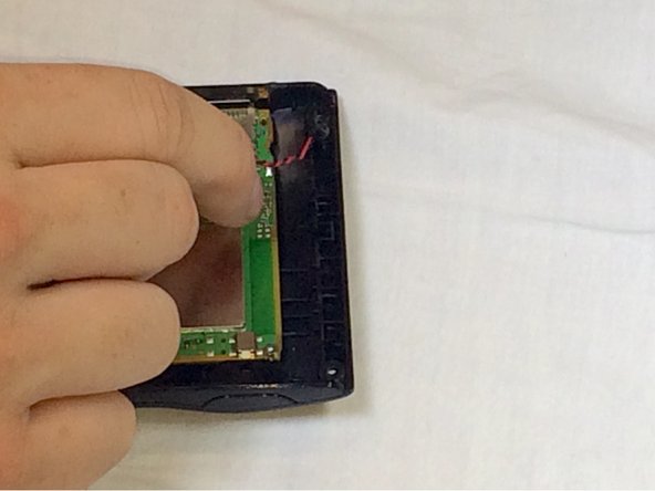

    • Use the plastic opening tool to pry open the device at the seam where the two halves meet, prying all along all sides if need be.
    • Do it slowly so you don't accidently rip the ribbon cable that connects the digitizer to the motherboard, as well as don't completely separate the halves as this can tear the ribbon cable.
    • Open your device from the top, so that you don't disconnect the ribbon cable.

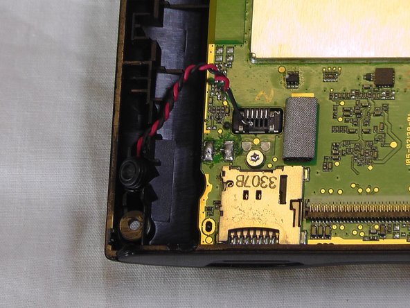

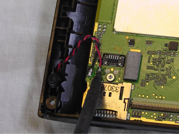

  3. Garmin Nuvi 2597LMT Microphone Replacement: crwdns2935265:03crwdnd2935265:01crwdnd2935265:03crwdne2935265:0 Garmin Nuvi 2597LMT Microphone Replacement: crwdns2935265:03crwdnd2935265:02crwdnd2935265:03crwdne2935265:0 Garmin Nuvi 2597LMT Microphone Replacement: crwdns2935265:03crwdnd2935265:03crwdnd2935265:03crwdne2935265:0
    • Use your soldering iron to disconnect the wires from the motherboard. Disconnect the ground wire (the black one) and the positive wire (the red one).
    • The soldering iron is very hot and do not touch the wires to anything as it may stick to it when it cools.
