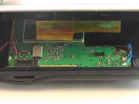

    • Turn your device over so the back is revealed and you can see the screws in the four corners.
    • Remove the four 3mm width by 6mm length T5 Torx screws using your screwdriver.
  2. Garmin Nuvi 2597LMT LCD Replacement: crwdns2935265:02crwdnd2935265:01crwdnd2935265:02crwdne2935265:0 Garmin Nuvi 2597LMT LCD Replacement: crwdns2935265:02crwdnd2935265:02crwdnd2935265:02crwdne2935265:0
    • Use the plastic opening tool to pry open the device at the seam where the two halves meet, prying all along all sides if need be.
    • Do it slowly so you don't accidently rip the ribbon cable that connects the digitizer to the motherboard, as well as don't completely separate the halves as this can tear the ribbon cable as well.

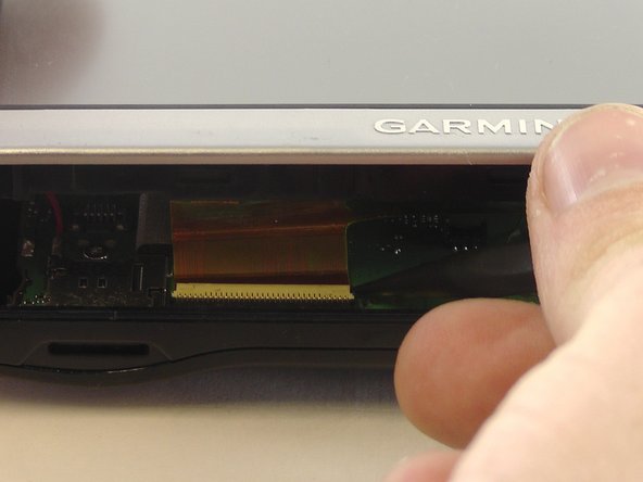

  3. Garmin Nuvi 2597LMT LCD Replacement: crwdns2935265:03crwdnd2935265:01crwdnd2935265:03crwdne2935265:0 Garmin Nuvi 2597LMT LCD Replacement: crwdns2935265:03crwdnd2935265:02crwdnd2935265:03crwdne2935265:0 Garmin Nuvi 2597LMT LCD Replacement: crwdns2935265:03crwdnd2935265:03crwdnd2935265:03crwdne2935265:0
    • Use your tweezers to flip back the tab of the ZIF (Zero Insertion Force) Connector, that is used to keep the ribbon cable in place.
    • This releases the ribbon cable separating the two halves of the device.

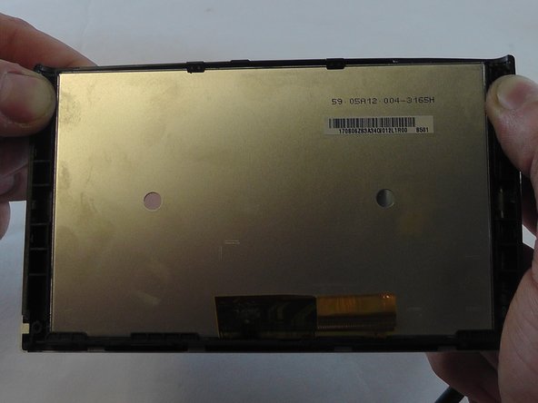

  4. Garmin Nuvi 2597LMT LCD Replacement: crwdns2935265:04crwdnd2935265:01crwdnd2935265:02crwdne2935265:0 Garmin Nuvi 2597LMT LCD Replacement: crwdns2935265:04crwdnd2935265:02crwdnd2935265:02crwdne2935265:0
    • Use your hands to pull back the clips that hold the LCD in place.
    • Once you have removed the LCD you can safely set it aside.
