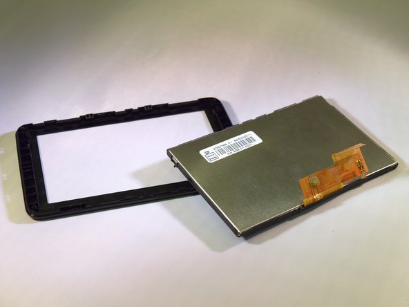

  4. Garmin Nuvi 2595LMT LCD Screen Replacement, LCD Screen: crwdns2935265:04crwdnd2935265:01crwdnd2935265:02crwdne2935265:0 Garmin Nuvi 2595LMT LCD Screen Replacement, LCD Screen: crwdns2935265:04crwdnd2935265:02crwdnd2935265:02crwdne2935265:0
    • Grabbing the top half of the Nuvi, remove the screen from the tabs holding it in place using thumbs.
    • Place screen on table.
  5. Garmin Nuvi 2595LMT LCD Screen Replacement: crwdns2935265:05crwdnd2935265:01crwdnd2935265:02crwdne2935265:0 Garmin Nuvi 2595LMT LCD Screen Replacement: crwdns2935265:05crwdnd2935265:02crwdnd2935265:02crwdne2935265:0
    • Place new screen in proper position, with the ribbon facing downward.
