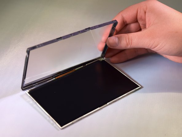

  4. Garmin Nuvi 2595LMT Digitizer Replacement, Digitizer: crwdns2935265:04crwdnd2935265:01crwdnd2935265:02crwdne2935265:0 Garmin Nuvi 2595LMT Digitizer Replacement, Digitizer: crwdns2935265:04crwdnd2935265:02crwdnd2935265:02crwdne2935265:0
    • Using the spudger, gently pry the sides of digitizer open until it lifts open and remove the digitizer from the LCD screen.
  5. Garmin Nuvi 2595LMT Digitizer Replacement: crwdns2935265:05crwdnd2935265:01crwdnd2935265:01crwdne2935265:0
    • Heat the connection between the digitizer ribbon’s and LCD Screen's ribbon with a hot soldering to separate the two.
    • After the connection is seperated, place the digitizer screen on your work surface.
    • Take the replacement digitizer and place it over the top of the LCD screen.
    • Align the ribbon of the digitizer and lay it over the LCD ribbon.
    • Place the solder underneath the digitizer ribbon and above the LCD ribbon; the area you need to solder is silver and at the bottom of the LCD ribbon.
    • Using the soldering iron, heat up the solder and attach the two ribbons.
    • Let the solder cool for an hour.
    • The soldering iron will be hot. Be careful to not burn yourself.
