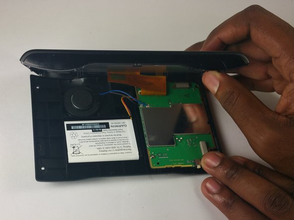

  3. Garmin Nuvi 2455LMT Touch Screen Replacement: crwdns2935265:03crwdnd2935265:01crwdnd2935265:03crwdne2935265:0 Garmin Nuvi 2455LMT Touch Screen Replacement: crwdns2935265:03crwdnd2935265:02crwdnd2935265:03crwdne2935265:0 Garmin Nuvi 2455LMT Touch Screen Replacement: crwdns2935265:03crwdnd2935265:03crwdnd2935265:03crwdne2935265:0
    • Open the device carefully being wary of the orange band that is going from the screen to the motherboard.
    • Remove the orange band by carefully lifting the lip that connects it to the motherboard.
