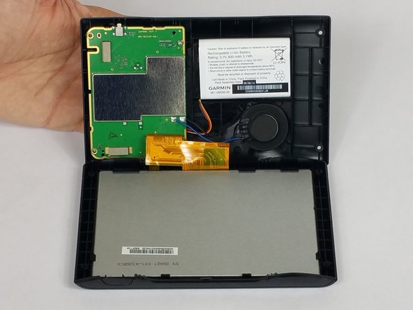

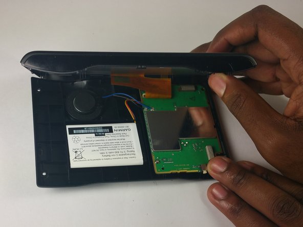

    • Use the plastic opening tool on all four sides of the device to open the Garmin Nuvi LMT2455 Back Panel.
  3. Garmin Nuvi 2455LMT Speaker Replacement: crwdns2935265:03crwdnd2935265:01crwdnd2935265:03crwdne2935265:0 Garmin Nuvi 2455LMT Speaker Replacement: crwdns2935265:03crwdnd2935265:02crwdnd2935265:03crwdne2935265:0 Garmin Nuvi 2455LMT Speaker Replacement: crwdns2935265:03crwdnd2935265:03crwdnd2935265:03crwdne2935265:0
    • Open the device carefully being weary of the orange band that is going from the screen to the mother board.

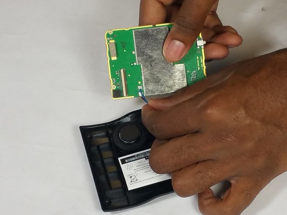

  4. Garmin Nuvi 2455LMT Speaker Replacement: crwdns2935265:04crwdnd2935265:01crwdnd2935265:02crwdne2935265:0 Garmin Nuvi 2455LMT Speaker Replacement: crwdns2935265:04crwdnd2935265:02crwdnd2935265:02crwdne2935265:0
    • Using the plastic prying tool, carefully pry the speaker from the plastic backing.
    • Remove the speaker from the motherboard by gently pulling on the wire.
