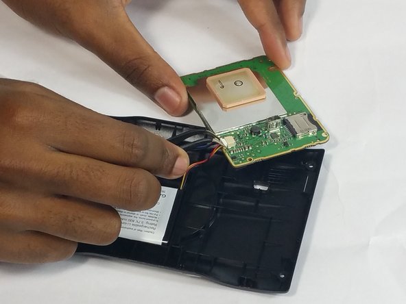

  4. Garmin Nuvi 2455LMT Mother Board Replacement, Mother Board: crwdns2935265:04crwdnd2935265:01crwdnd2935265:01crwdne2935265:0
    • Remove the two 1.0mm 04# Torx screws from the mother board assembly
    • One screw can be found directly to the right of the battery and one screw can be found behind the orange band.
    • Hold the GPS with a free hand to ensure stability.
  5. Garmin Nuvi 2455LMT Mother Board Replacement: crwdns2935265:05crwdnd2935265:01crwdnd2935265:02crwdne2935265:0 Garmin Nuvi 2455LMT Mother Board Replacement: crwdns2935265:05crwdnd2935265:02crwdnd2935265:02crwdne2935265:0
    • Place the screen portion of the GPS face down.
    • Remove the mother board from the plastic back panel.
    • Disconnect the battery with tweezers by gripping the white socket displayed in the photo. Wiggle the white socket out of the mother board.
  6. Garmin Nuvi 2455LMT Mother Board Replacement: crwdns2935265:06crwdnd2935265:01crwdnd2935265:01crwdne2935265:0
    • Use a soldering tool to de-solder the connection to the motherboard. Refer to the iFixit Soldering guide to see how
