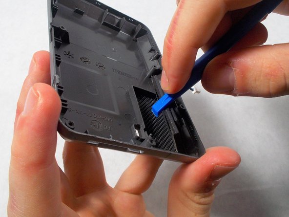

  8. Garmin Nuvi 200w Speaker Replacement, Speaker: crwdns2935265:08crwdnd2935265:01crwdnd2935265:03crwdne2935265:0 Garmin Nuvi 200w Speaker Replacement, Speaker: crwdns2935265:08crwdnd2935265:02crwdnd2935265:03crwdne2935265:0 Garmin Nuvi 200w Speaker Replacement, Speaker: crwdns2935265:08crwdnd2935265:03crwdnd2935265:03crwdne2935265:0
    • Using the plastic opening tool, carefully apply pressure to lift the speaker up from the back cover.
    • There may be some type of adhesive around the edges of the speaker.
