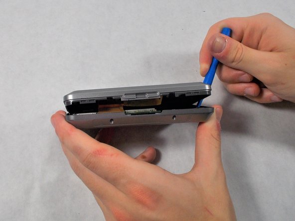

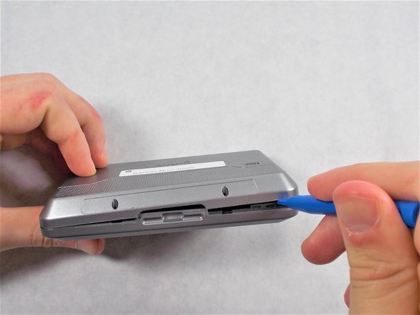

    • Carefully, using your plastic opening tools find the crease which separates the front and rear covers.
    • Once you have a little gap, work it around the whole device with the tool to get separation.
    • There is a ribbon cable between the two covers, be very careful when taking them apart to not damage the ribbon.

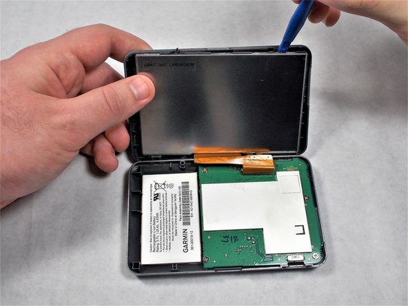

    • After the case front and rear are separated, carefully lay the two sides down without disconnecting or damaging the orange ribbon cable.

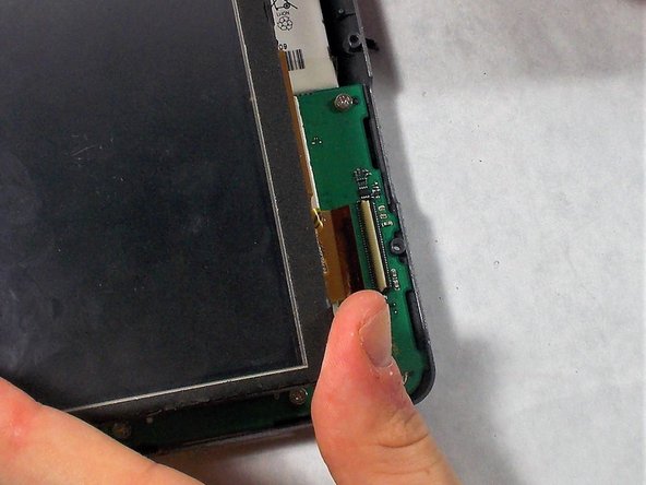

    • Carefully use the black spudger to lift the white retaining clamp on the display cable ZIF connector.
    • Make sure to lift up on the white retaining clamp and not the ZIF connector itself.
    • Slide the orange ribbon cable away from the ZIF connector.

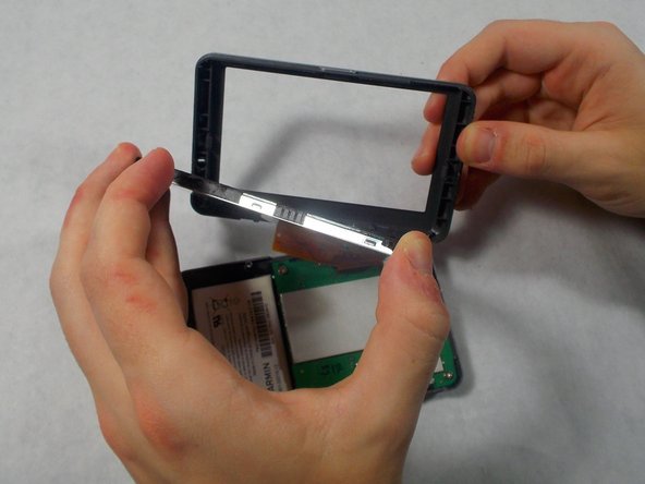

    • Using your plastic opening tool, apply pressure on the top right of the screen in order to remove some of the tabs.
    • Work the plastic opening tool around the whole screen to remove the tabs from the screen.
    • Carefully separate the screen from the front cover.
