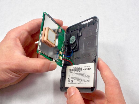

    • Peel off the sticker in order to find the two Torx T5 screws.
  2. Garmin Nuvi 200w Motherboard Replacement: crwdns2935265:02crwdnd2935265:01crwdnd2935265:01crwdne2935265:0
    • Remove the two 4mm T5 Torx screws.
  3. Garmin Nuvi 200w Motherboard Replacement: crwdns2935265:03crwdnd2935265:01crwdnd2935265:03crwdne2935265:0 Garmin Nuvi 200w Motherboard Replacement: crwdns2935265:03crwdnd2935265:02crwdnd2935265:03crwdne2935265:0 Garmin Nuvi 200w Motherboard Replacement: crwdns2935265:03crwdnd2935265:03crwdnd2935265:03crwdne2935265:0
    • Carefully, using your plastic opening tools find the crease which separates the front and rear covers.
    • Once you have a little gap, work it around the whole device with the tool to get separation.
    • There is a ribbon cable between the two covers, be very careful when taking them apart to not damage the ribbon.
  4. Garmin Nuvi 200w Motherboard Replacement: crwdns2935265:04crwdnd2935265:01crwdnd2935265:02crwdne2935265:0 Garmin Nuvi 200w Motherboard Replacement: crwdns2935265:04crwdnd2935265:02crwdnd2935265:02crwdne2935265:0
    • After the case front and rear are separated, carefully lay the two sides down without disconnecting or damaging the orange ribbon cable.
  5. Garmin Nuvi 200w Motherboard Replacement, Display Assembly: crwdns2935265:05crwdnd2935265:01crwdnd2935265:03crwdne2935265:0 Garmin Nuvi 200w Motherboard Replacement, Display Assembly: crwdns2935265:05crwdnd2935265:02crwdnd2935265:03crwdne2935265:0 Garmin Nuvi 200w Motherboard Replacement, Display Assembly: crwdns2935265:05crwdnd2935265:03crwdnd2935265:03crwdne2935265:0
    • Carefully use the black spudger to lift the white retaining clamp on the display cable ZIF connector.
    • Make sure to lift up on the white retaining clamp and not the ZIF connector itself.
    • Slide the orange ribbon cable away from the ZIF connector.
  6. Garmin Nuvi 200w Motherboard Replacement, Motherboard: crwdns2935265:06crwdnd2935265:01crwdnd2935265:02crwdne2935265:0 Garmin Nuvi 200w Motherboard Replacement, Motherboard: crwdns2935265:06crwdnd2935265:02crwdnd2935265:02crwdne2935265:0
    • Using a screw driver, unscrew the four 2mm screws holding the motherboard in place.
    • Gently lift the motherboard away from the rear cover. Take care to not damage the wires or ports that link the motherboard to other components.
  7. Garmin Nuvi 200w Motherboard Replacement: crwdns2935265:07crwdnd2935265:01crwdnd2935265:03crwdne2935265:0 Garmin Nuvi 200w Motherboard Replacement: crwdns2935265:07crwdnd2935265:02crwdnd2935265:03crwdne2935265:0 Garmin Nuvi 200w Motherboard Replacement: crwdns2935265:07crwdnd2935265:03crwdnd2935265:03crwdne2935265:0
    • Using the black spudger, apply pressure to nudge the plug out of its port.
    • Repeat this process for both ports.
