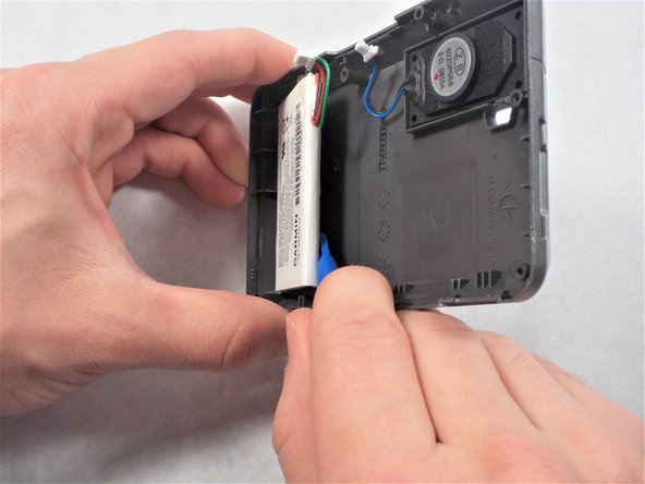

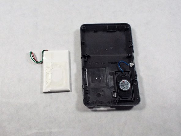

  8. Garmin Nuvi 200w Battery Replacement, Battery: crwdns2935265:08crwdnd2935265:01crwdnd2935265:03crwdne2935265:0 Garmin Nuvi 200w Battery Replacement, Battery: crwdns2935265:08crwdnd2935265:02crwdnd2935265:03crwdne2935265:0 Garmin Nuvi 200w Battery Replacement, Battery: crwdns2935265:08crwdnd2935265:03crwdnd2935265:03crwdne2935265:0
    • Using your opening tools, separate the battery from the top side. Very slowly push your tool down into the crevice.
    • Be careful because the battery is glued to the rear cover, so it does take some force to separate.
    • Once you have a gap big enough, pull the battery off the cover.
