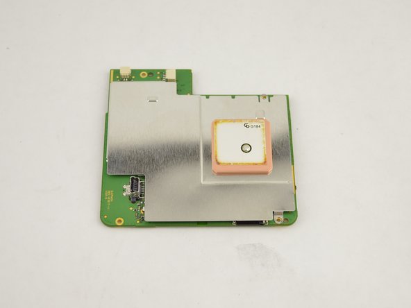

  9. Garmin Nuvi 1490T USB Port Replacement, USB Port: crwdns2935265:09crwdnd2935265:01crwdnd2935265:02crwdne2935265:0 Garmin Nuvi 1490T USB Port Replacement, USB Port: crwdns2935265:09crwdnd2935265:02crwdnd2935265:02crwdne2935265:0
    • Use your T5 Torx screwdriver and unscrew the two 5.0 mm screws on the motherboard.
  10. Garmin Nuvi 1490T USB Port Replacement: crwdns2935265:010crwdnd2935265:01crwdnd2935265:02crwdne2935265:0 Garmin Nuvi 1490T USB Port Replacement: crwdns2935265:010crwdnd2935265:02crwdnd2935265:02crwdne2935265:0
    • Flip the motherboard over towards the battery.
    • Use your tweezers and disconnect the two wire connectors from the motherboard.
    • Pull the motherboard out and locate the USB port.
  11. Garmin Nuvi 1490T USB Port Replacement: crwdns2935265:011crwdnd2935265:01crwdnd2935265:02crwdne2935265:0 Garmin Nuvi 1490T USB Port Replacement: crwdns2935265:011crwdnd2935265:02crwdnd2935265:02crwdne2935265:0
    • If this is your first time solder here is a link on how to solder. How To Solder and Desolder Connections
    • Gently and delicately heat up the solder holding the USB port to the circuit board.
    • Carefully remove the USB port with your metal tweezers and set it aside
