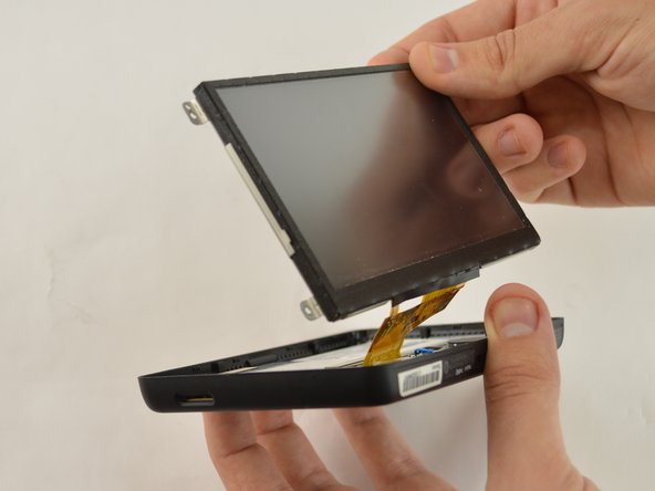

  6. Garmin Nuvi 1490T Display Screen Replacement, Display Screen: crwdns2935265:06crwdnd2935265:01crwdnd2935265:03crwdne2935265:0 Garmin Nuvi 1490T Display Screen Replacement, Display Screen: crwdns2935265:06crwdnd2935265:02crwdnd2935265:03crwdne2935265:0 Garmin Nuvi 1490T Display Screen Replacement, Display Screen: crwdns2935265:06crwdnd2935265:03crwdnd2935265:03crwdne2935265:0
    • Gently lift up the display screen using your fingers to make sure the only thing connecting it to the body is the ribbon cable.
  7. Garmin Nuvi 1490T Display Screen Replacement: crwdns2935265:07crwdnd2935265:01crwdnd2935265:02crwdne2935265:0 Garmin Nuvi 1490T Display Screen Replacement: crwdns2935265:07crwdnd2935265:02crwdnd2935265:02crwdne2935265:0

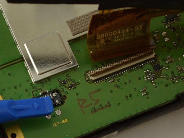

    • Remove the piece of tape that is covering the connecting point of the motherboard and display.
  8. Garmin Nuvi 1490T Display Screen Replacement: crwdns2935265:08crwdnd2935265:01crwdnd2935265:03crwdne2935265:0 Garmin Nuvi 1490T Display Screen Replacement: crwdns2935265:08crwdnd2935265:02crwdnd2935265:03crwdne2935265:0 Garmin Nuvi 1490T Display Screen Replacement: crwdns2935265:08crwdnd2935265:03crwdnd2935265:03crwdne2935265:0
    • Using the plastic opening tool or your fingers, lift up the ZIF connector holding the ribbon cable in place.
    • Carefully pull the ribbon cable out of the connector with tweezers or two fingers.
    • Gently disconnect the display by pulling upward. Set display aside.
    • If the display screen does not disconnect easily, make sure the ZIF connector is no longer holding it in place.
