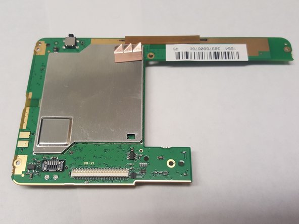

Garmin Nuvi 1390LMT Logic Board Replacement
  1. Garmin Nuvi 1390LMT Logic Board Replacement, Logic Board: crwdns2935265:01crwdnd2935265:01crwdnd2935265:01crwdne2935265:0
    • Snap the plastic cover off using a plastic opening tool.
  2. Garmin Nuvi 1390LMT Logic Board Replacement: crwdns2935265:02crwdnd2935265:01crwdnd2935265:02crwdne2935265:0 Garmin Nuvi 1390LMT Logic Board Replacement: crwdns2935265:02crwdnd2935265:02crwdnd2935265:02crwdne2935265:0
    • Remove the four black 11 mm T5 torx screws.
  3. Garmin Nuvi 1390LMT Logic Board Replacement: crwdns2935265:03crwdnd2935265:01crwdnd2935265:01crwdne2935265:0
    • Pop the screen cover off with a plastic opening tool.
  4. Garmin Nuvi 1390LMT Logic Board Replacement: crwdns2935265:04crwdnd2935265:01crwdnd2935265:01crwdne2935265:0
    • Gently pull the wire ribbon connecting the screen to the logic board from the plug.
    • Be careful when unplugging the wire ribbon. It is very fragile.
  5. Garmin Nuvi 1390LMT Logic Board Replacement: crwdns2935265:05crwdnd2935265:01crwdnd2935265:01crwdne2935265:0
    • Remove the two silver 5 mm T5 torx screws connecting the circuit board to the plastic casing.
  6. Garmin Nuvi 1390LMT Logic Board Replacement: crwdns2935265:06crwdnd2935265:01crwdnd2935265:01crwdne2935265:0
    • Flip the logic board over.
  7. Garmin Nuvi 1390LMT Logic Board Replacement: crwdns2935265:07crwdnd2935265:01crwdnd2935265:02crwdne2935265:0 Garmin Nuvi 1390LMT Logic Board Replacement: crwdns2935265:07crwdnd2935265:02crwdnd2935265:02crwdne2935265:0
    • Disconnect the harness between the battery and the logic board.
