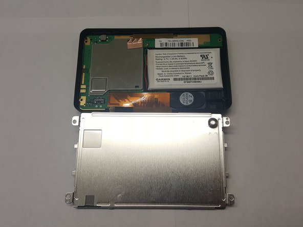

  4. Garmin Nuvi 1390LMT Battery Replacement: crwdns2935265:04crwdnd2935265:01crwdnd2935265:02crwdne2935265:0 Garmin Nuvi 1390LMT Battery Replacement: crwdns2935265:04crwdnd2935265:02crwdnd2935265:02crwdne2935265:0
    • Flip the screen over out of the case.
    • Be sure not to twist or damage the wiring harness connecting the screen to the circuit board.
  5. Garmin Nuvi 1390LMT Battery Replacement: crwdns2935265:05crwdnd2935265:01crwdnd2935265:01crwdne2935265:0
    • Remove the two silver 5 mm T5 torx screws connecting the circuit board to the plastic casing.
  6. Garmin Nuvi 1390LMT Battery Replacement: crwdns2935265:06crwdnd2935265:01crwdnd2935265:02crwdne2935265:0 Garmin Nuvi 1390LMT Battery Replacement: crwdns2935265:06crwdnd2935265:02crwdnd2935265:02crwdne2935265:0
    • Flip the circuit board over onto the screen.
  7. Garmin Nuvi 1390LMT Battery Replacement: crwdns2935265:07crwdnd2935265:01crwdnd2935265:01crwdne2935265:0
    • Disconnect the harness between the battery and the circuit board.
  8. Garmin Nuvi 1390LMT Battery Replacement: crwdns2935265:08crwdnd2935265:01crwdnd2935265:02crwdne2935265:0 Garmin Nuvi 1390LMT Battery Replacement: crwdns2935265:08crwdnd2935265:02crwdnd2935265:02crwdne2935265:0
    • Peel the battery from the plastic back with a plastic opening tool.
    • It is connected with a glue so be careful.
