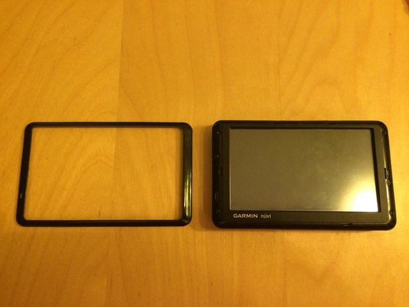

    • Using your spudger, remove the plastic frame around the screen.
    • Take it easy and it will snap right off.
    • If you don't take it easy, it may snap right in half, and we don't want that.

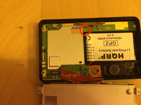

  6. Garmin Nuvi 1370 Battery Replacement: crwdns2935265:06crwdnd2935265:01crwdnd2935265:02crwdne2935265:0 Garmin Nuvi 1370 Battery Replacement: crwdns2935265:06crwdnd2935265:02crwdnd2935265:02crwdne2935265:0
    • With the bezel removed, flip the screen out. Be careful with that ribbon cable.
    • There is no need to disconnect the screen.
    • Using your T5 driver, remove the two screws that hold the circuit board in place.
  7. Garmin Nuvi 1370 Battery Replacement: crwdns2935265:07crwdnd2935265:01crwdnd2935265:02crwdne2935265:0 Garmin Nuvi 1370 Battery Replacement: crwdns2935265:07crwdnd2935265:02crwdnd2935265:02crwdne2935265:0

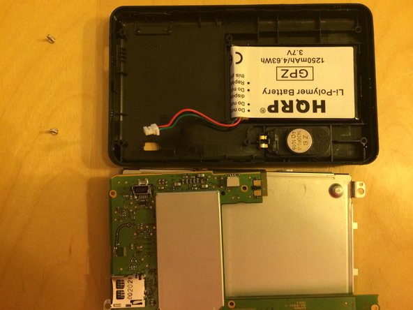

    • Flip the circuit board over and remove it from the case. It may need some persuasion in the upper left corner [as positioned here].
    • Once flipped over, disconnect the old battery.
  8. Garmin Nuvi 1370 Battery Replacement: crwdns2935265:08crwdnd2935265:01crwdnd2935265:01crwdne2935265:0
    • The existing battery is glued in place. It will take a bit of prying to remove it. Be careful you don't puncture the battery.
    • I slowly worked a flat-blade screwdriver under the battery, prying it up a bit at a time.
    • Replace the old battery with the new one. I didn't bother to glue the new one in place, as it is nestled securely in a plastic cavity within the case. Plug it in to the circuit board, and reverse the disassembly steps.
