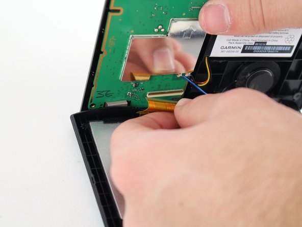

  6. Garmin Nüvi 52LM USB Charge Port Replacement, USB Charge Port: crwdns2935265:06crwdnd2935265:01crwdnd2935265:02crwdne2935265:0 Garmin Nüvi 52LM USB Charge Port Replacement, USB Charge Port: crwdns2935265:06crwdnd2935265:02crwdnd2935265:02crwdne2935265:0
    • On the motherboard, lift the small plate that holds the orange ribbon wire in place.
    • Gently disconnect the ribbon wire from its connection to the motherboard.

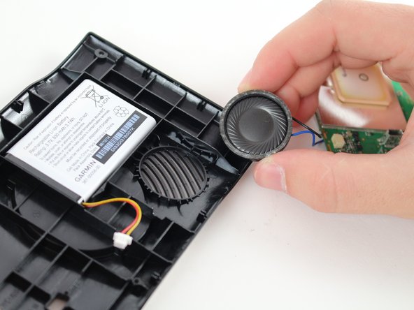

  7. Garmin Nüvi 52LM USB Charge Port Replacement: crwdns2935265:07crwdnd2935265:01crwdnd2935265:02crwdne2935265:0 Garmin Nüvi 52LM USB Charge Port Replacement: crwdns2935265:07crwdnd2935265:02crwdnd2935265:02crwdne2935265:0
    • Using a plastic opening tool, pry the speaker from the back plate of the device. There may be a small amount of adhesive connecting the two, so you may need to use a small amount of force.
    • The motherboard and USB charge port should now be completely detached from the other parts of the device, and a new one can now be placed.
