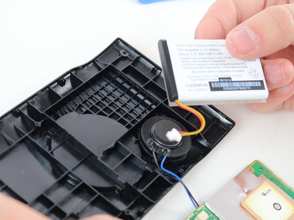

  4. Garmin Nüvi 52LM LCD and Digitizer Replacement: crwdns2935265:04crwdnd2935265:01crwdnd2935265:02crwdne2935265:0 Garmin Nüvi 52LM LCD and Digitizer Replacement: crwdns2935265:04crwdnd2935265:02crwdnd2935265:02crwdne2935265:0
    • Gently unplug the wire connecting the battery to the small socket on the back of the motherboard.
  5. Garmin Nüvi 52LM LCD and Digitizer Replacement: crwdns2935265:05crwdnd2935265:01crwdnd2935265:02crwdne2935265:0 Garmin Nüvi 52LM LCD and Digitizer Replacement: crwdns2935265:05crwdnd2935265:02crwdnd2935265:02crwdne2935265:0
    • Using a plastic opening tool, pry the battery from the back cover of the device. There may be an adhesive sticker keeping it in place, so you may need to apply some force.
    • The battery should now be completely detached from the other parts.

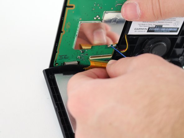

  6. Garmin Nüvi 52LM LCD and Digitizer Replacement, LCD and Digitizer: crwdns2935265:06crwdnd2935265:01crwdnd2935265:02crwdne2935265:0 Garmin Nüvi 52LM LCD and Digitizer Replacement, LCD and Digitizer: crwdns2935265:06crwdnd2935265:02crwdnd2935265:02crwdne2935265:0
    • On the motherboard, lift the small plate that holds the orange ribbon wire in place.
    • Gently disconnect the ribbon wire from its connection to the motherboard.

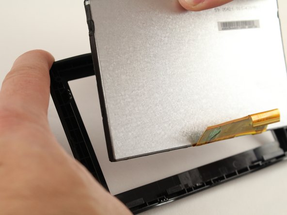

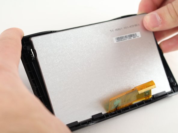

  7. Garmin Nüvi 52LM LCD and Digitizer Replacement: crwdns2935265:07crwdnd2935265:01crwdnd2935265:03crwdne2935265:0 Garmin Nüvi 52LM LCD and Digitizer Replacement: crwdns2935265:07crwdnd2935265:02crwdnd2935265:03crwdne2935265:0 Garmin Nüvi 52LM LCD and Digitizer Replacement: crwdns2935265:07crwdnd2935265:03crwdnd2935265:03crwdne2935265:0
    • Using a moderate amount of force, pull each of the triangular hooks holding the screen in place away.
    • Once all of the triangular hooks are off of the screen, slide the device out of the case, pulling away from the rectangular hooks at the bottom.
    • The screen and digitizer should now be completely detached from the other parts of the device, and a new one can now be placed.
