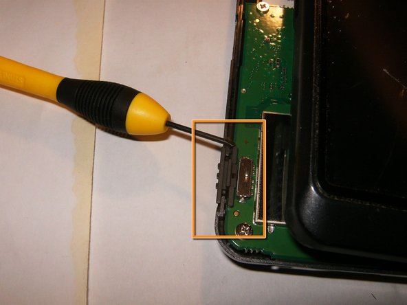

    • Remove the label, then remove the two Torx T5 screws
    • Use a plastic opening tool to start splitting the front and back case.
    • Work your way around the separation line, gently applying continous pressure to the back case.

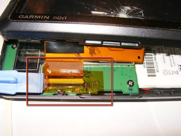

    • Once the front and back case are split, do not yet totally remove it. The LCD is still attached via a ribbon cable.
    • The ribbon cable and connector are covered with a strip of Kapton tape
    • Remove the tape. Use the plastic opening tool, or any other appropriate tool (i.e. guitar pick, fingernails etc), to remove the tape.

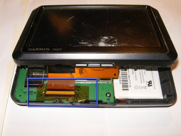

  4. Garmin Nüvi 205W LCD Display Replacement: crwdns2935265:04crwdnd2935265:01crwdnd2935265:03crwdne2935265:0 Garmin Nüvi 205W LCD Display Replacement: crwdns2935265:04crwdnd2935265:02crwdnd2935265:03crwdne2935265:0 Garmin Nüvi 205W LCD Display Replacement: crwdns2935265:04crwdnd2935265:03crwdnd2935265:03crwdne2935265:0
    • Once the tape is removed, flip the white clasp open, by moving it away from the cable end, disconnect the LCD.
    • Remove the On/Off switch
    • Remove the complete front assembly.

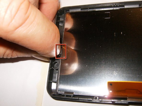

  5. Garmin Nüvi 205W LCD Display Replacement: crwdns2935265:05crwdnd2935265:01crwdnd2935265:03crwdne2935265:0 Garmin Nüvi 205W LCD Display Replacement: crwdns2935265:05crwdnd2935265:02crwdnd2935265:03crwdne2935265:0 Garmin Nüvi 205W LCD Display Replacement: crwdns2935265:05crwdnd2935265:03crwdnd2935265:03crwdne2935265:0

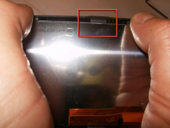

    • The LCD assembly is held in the front bezel by seven plastic tabs.
    • Move those tabs slightly back while applying pressure from the opposite side (front of the LCD)
    • Continue to push the tabs on the bezel away from the LCD assembly, pushing the LCD away from the bezel
  6. Garmin Nüvi 205W LCD Display Replacement: crwdns2935265:06crwdnd2935265:01crwdnd2935265:03crwdne2935265:0 Garmin Nüvi 205W LCD Display Replacement: crwdns2935265:06crwdnd2935265:02crwdnd2935265:03crwdne2935265:0 Garmin Nüvi 205W LCD Display Replacement: crwdns2935265:06crwdnd2935265:03crwdnd2935265:03crwdne2935265:0

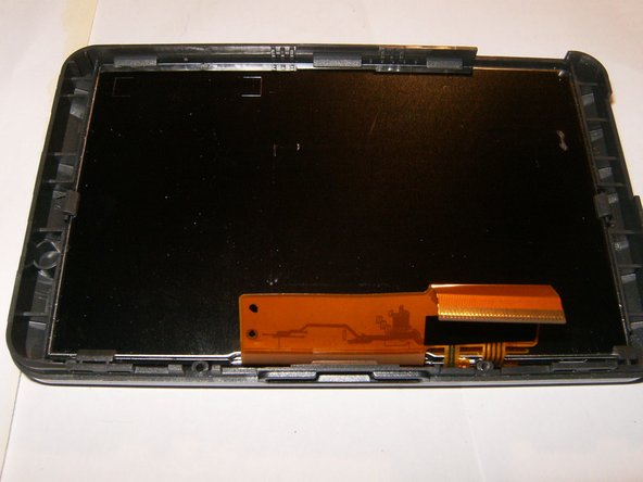

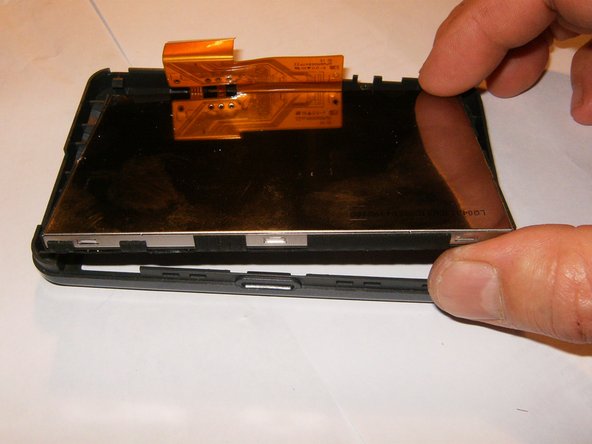

    • Ensure that the LCD assembly clears all the tabs.
    • Remove the LCD from the front bezel
    • Totally separate the assembly from the bezel. Now it is time to replace it with a new assembly.
