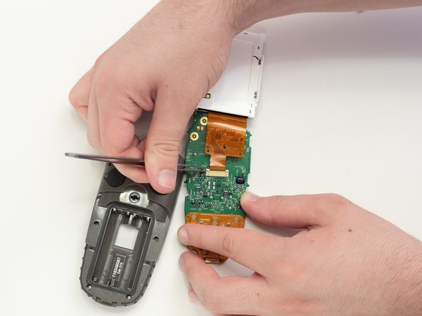

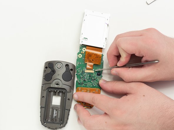

  9. Garmin GPSmap 60CSx Screen Replacement: crwdns2935265:09crwdnd2935265:01crwdnd2935265:03crwdne2935265:0 Garmin GPSmap 60CSx Screen Replacement: crwdns2935265:09crwdnd2935265:02crwdnd2935265:03crwdne2935265:0 Garmin GPSmap 60CSx Screen Replacement: crwdns2935265:09crwdnd2935265:03crwdnd2935265:03crwdne2935265:0
    • Use tweezers to pull the two white pins on the connector forward.
  10. Garmin GPSmap 60CSx Screen Replacement: crwdns2935265:010crwdnd2935265:01crwdnd2935265:01crwdne2935265:0
    • Remove the screen ribbon connector and screen.
