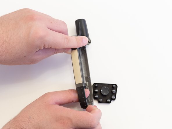

  7. Garmin GPSmap 60CSx Keypad Buttons Replacement: crwdns2935265:07crwdnd2935265:01crwdnd2935265:02crwdne2935265:0 Garmin GPSmap 60CSx Keypad Buttons Replacement: crwdns2935265:07crwdnd2935265:02crwdnd2935265:02crwdne2935265:0
    • Take the front panel and apply light force to the buttons.
    • The buttons are part of one unit and should all pop out at once.
