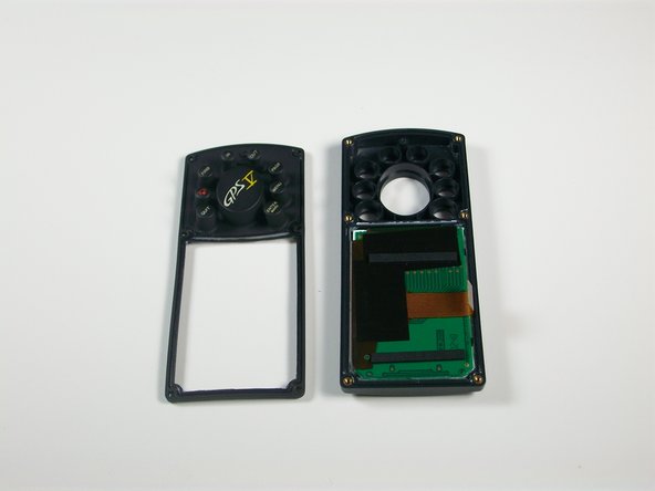

  8. Garmin GPS V Front Plate Replacement, Button Pad: crwdns2935265:08crwdnd2935265:01crwdnd2935265:03crwdne2935265:0 Garmin GPS V Front Plate Replacement, Button Pad: crwdns2935265:08crwdnd2935265:02crwdnd2935265:03crwdne2935265:0 Garmin GPS V Front Plate Replacement, Button Pad: crwdns2935265:08crwdnd2935265:03crwdnd2935265:03crwdne2935265:0
    • Gently pry the button pad off of the front plate.

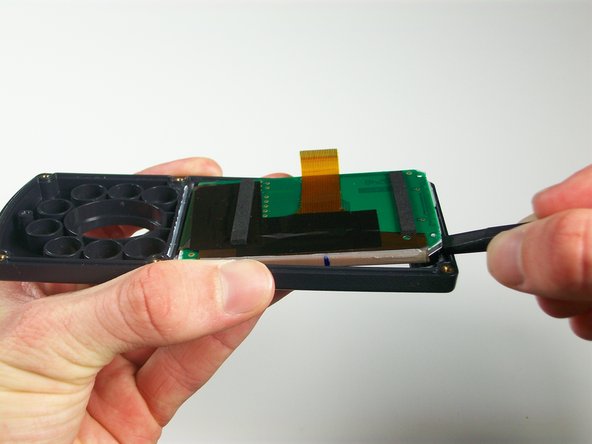

  9. Garmin GPS V Front Plate Replacement, Display: crwdns2935265:09crwdnd2935265:01crwdnd2935265:03crwdne2935265:0 Garmin GPS V Front Plate Replacement, Display: crwdns2935265:09crwdnd2935265:02crwdnd2935265:03crwdne2935265:0 Garmin GPS V Front Plate Replacement, Display: crwdns2935265:09crwdnd2935265:03crwdnd2935265:03crwdne2935265:0
    • Orient the front plate of the device so the display board is facing up.
    • With the spudger, gently work your way around the display assembly.
    • NOTE: The display assembly is composed of three parts and is glued to the case. Be careful to not separate it when prying it out.
    • Pry the display free of the front plate.
  10. Garmin GPS V Front Plate Replacement, Front Plate: crwdns2935265:010crwdnd2935265:01crwdnd2935265:01crwdne2935265:0
    • With the display removed, the front case of the Garmin GPS can be replaced.
