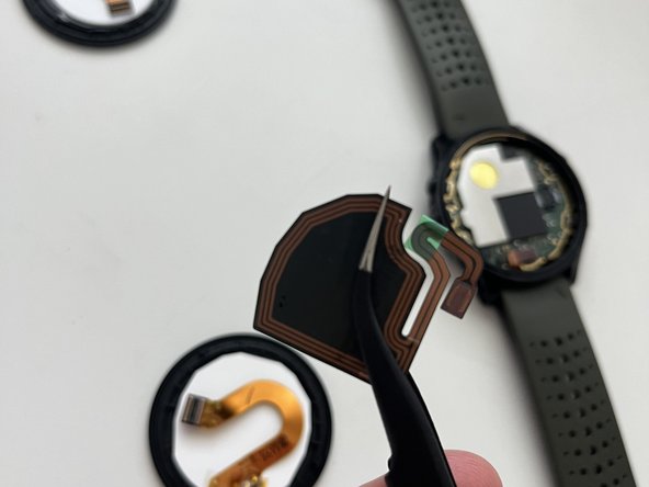

  6. Garmin Forerunner 945 Screen Replacement, (Optional) remove NFC antenna: crwdns2935265:06crwdnd2935265:01crwdnd2935265:02crwdne2935265:0 Garmin Forerunner 945 Screen Replacement, (Optional) remove NFC antenna: crwdns2935265:06crwdnd2935265:02crwdnd2935265:02crwdne2935265:0
    • Depending on if your replacement came with this black piece (mine did not), you may want to use this on your new screen. I used tweezers to gently peel it off and stick on the new screen. Just make sure you see exactly where it is placed before removing because the ribbon cable connectors need to align properly.
