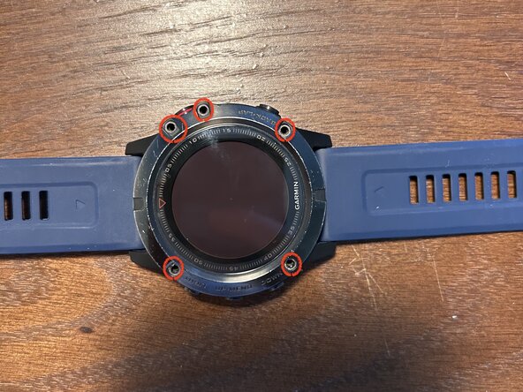

    • Remove the five screws surrounding the display using a Torx T7 bit.
    • Please take note of how tight they are so you can achieve the same torque during final reassembly.
    • Carefully lift up the display.

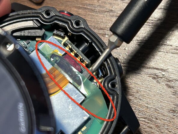

  2. Garmin Fenix 5x Battery Replacement: crwdns2935265:02crwdnd2935265:01crwdnd2935265:01crwdne2935265:0
    • Remove the green sticker covering the two press connectors.
    • Save this for later; you might be able to reinstall it at the end. If not, no worries.
