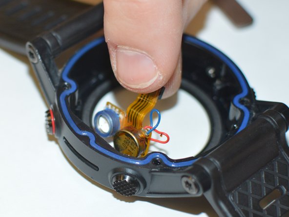

  12. Garmin Fenix 2 Housing Replacement, Housing: crwdns2935265:012crwdnd2935265:01crwdnd2935265:02crwdne2935265:0 Garmin Fenix 2 Housing Replacement, Housing: crwdns2935265:012crwdnd2935265:02crwdnd2935265:02crwdne2935265:0
    • Use a spudger tool to pry the soundboard out of its housing.
