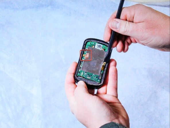

      • Peel back the tape holding down the orange ribbon cables with the nylon halberd spudger.
    4. Garmin Edge 530 Battery Replacement: crwdns2935265:04crwdnd2935265:01crwdnd2935265:01crwdne2935265:0
      • Completely detach the screen from the back cover by disconnecting the orange ribbon cables.
      • Be sure to reconnect the orange ribbon cables from the new LCD screen at the original attachment site.

      • Detach the press-fit connector from the motherboard using the nylon halberd spudger.
      • Gently peel back the copper adhesive strip to free the remaining bonding cable.
