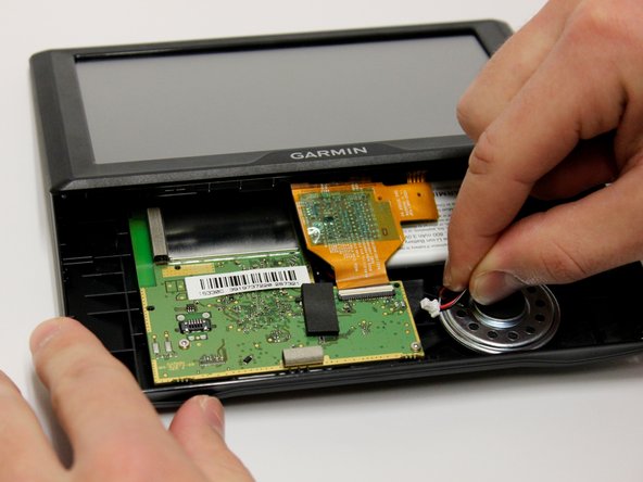

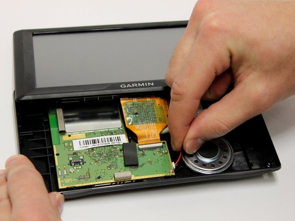

    • Flip the device over with the screen facing upward and open the device.
  3. Garmin Drive 60LM Speaker Replacement: crwdns2935265:03crwdnd2935265:01crwdnd2935265:03crwdne2935265:0 Garmin Drive 60LM Speaker Replacement: crwdns2935265:03crwdnd2935265:02crwdnd2935265:03crwdne2935265:0 Garmin Drive 60LM Speaker Replacement: crwdns2935265:03crwdnd2935265:03crwdnd2935265:03crwdne2935265:0
    • Use a plastic spudger tool to lift the wires from behind the motherboard.
    • Carefully disconnect the wires attaching the speaker to the motherboard using your fingers.
  4. Garmin Drive 60LM Speaker Replacement: crwdns2935265:04crwdnd2935265:01crwdnd2935265:02crwdne2935265:0 Garmin Drive 60LM Speaker Replacement: crwdns2935265:04crwdnd2935265:02crwdnd2935265:02crwdne2935265:0
    • Using a plastic spudger and your fingers, remove the speaker from the device.
