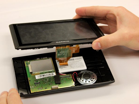

      • Flip the device over with the screen facing upward and open the device.

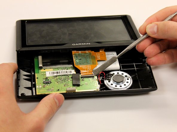

    3. Garmin Drive 60LM Screen Replacement: crwdns2935265:03crwdnd2935265:01crwdnd2935265:03crwdne2935265:0 Garmin Drive 60LM Screen Replacement: crwdns2935265:03crwdnd2935265:02crwdnd2935265:03crwdne2935265:0 Garmin Drive 60LM Screen Replacement: crwdns2935265:03crwdnd2935265:03crwdnd2935265:03crwdne2935265:0
      • Use a plastic spudger to flip up the white clamp holding the orange ribbon in place to the motherboard.
      • Lift the screen and orange ribbon away from the motherboard.
      • The metal spudger pictured is not ESD safe. Use a plastic spudger instead.

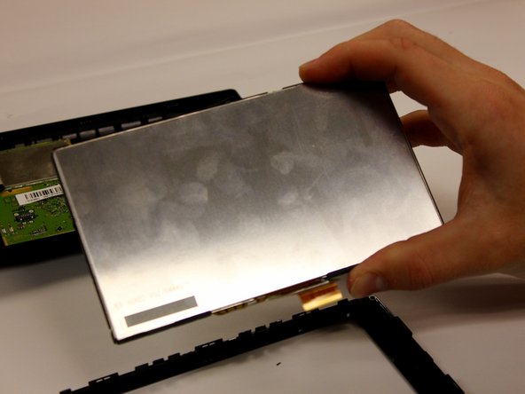

    4. Garmin Drive 60LM Screen Replacement: crwdns2935265:04crwdnd2935265:01crwdnd2935265:02crwdne2935265:0 Garmin Drive 60LM Screen Replacement: crwdns2935265:04crwdnd2935265:02crwdnd2935265:02crwdne2935265:0
      • Carefully unsnap the plastic border surrounding the screen.
