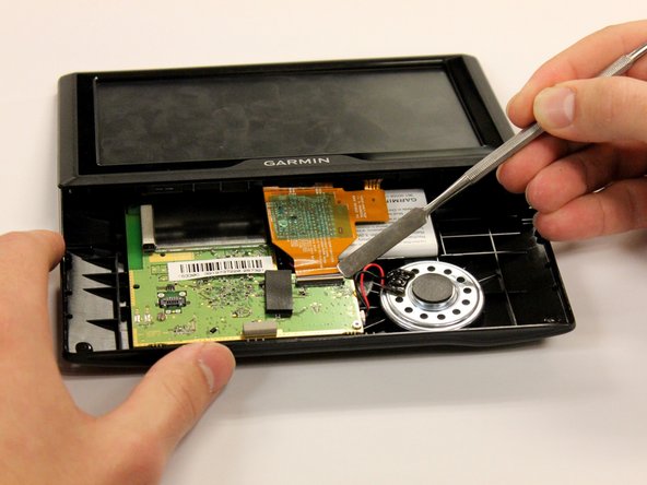

    3. Garmin Drive 60LM Motherboard Replacement: crwdns2935265:03crwdnd2935265:01crwdnd2935265:03crwdne2935265:0 Garmin Drive 60LM Motherboard Replacement: crwdns2935265:03crwdnd2935265:02crwdnd2935265:03crwdne2935265:0 Garmin Drive 60LM Motherboard Replacement: crwdns2935265:03crwdnd2935265:03crwdnd2935265:03crwdne2935265:0
      • Use a plastic spudger to flip up the white clamp holding the orange ribbon in place to the motherboard.
      • Lift the screen and orange ribbon away from the motherboard.
      • The metal spudger pictured is not ESD safe. Use a plastic spudger instead.
