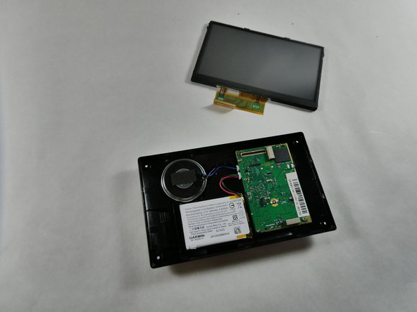

    • Pop the suction cup off of the device.
    • Unscrew the four T5 Torx screws on the back.
    • Carefully pry apart the front and back with a Jimmy.
  2. Garmin Drive 52 and Traffic Screen Replacement: crwdns2935265:02crwdnd2935265:01crwdnd2935265:03crwdne2935265:0 Garmin Drive 52 and Traffic Screen Replacement: crwdns2935265:02crwdnd2935265:02crwdnd2935265:03crwdne2935265:0 Garmin Drive 52 and Traffic Screen Replacement: crwdns2935265:02crwdnd2935265:03crwdnd2935265:03crwdne2935265:0
    • Pop the screen out of the front casing.
  3. Garmin Drive 52 and Traffic Screen Replacement: crwdns2935265:03crwdnd2935265:01crwdnd2935265:02crwdne2935265:0 Garmin Drive 52 and Traffic Screen Replacement: crwdns2935265:03crwdnd2935265:02crwdnd2935265:02crwdne2935265:0
    • Flip up the ZIF connector's lock bar, remove the ribbon cable, and pull the screen out.
