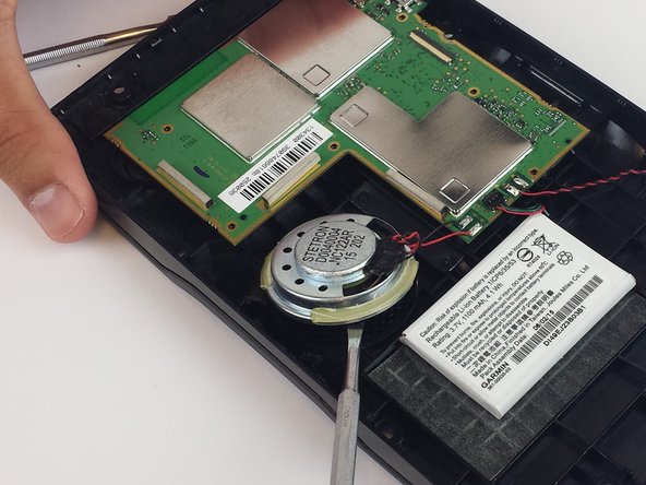

  4. Garmin Dezl 770LMT Speaker Replacement, Speaker: crwdns2935265:04crwdnd2935265:01crwdnd2935265:02crwdne2935265:0 Garmin Dezl 770LMT Speaker Replacement, Speaker: crwdns2935265:04crwdnd2935265:02crwdnd2935265:02crwdne2935265:0
    • Using the sharp side of the spudger, scrape away the adhesive surrounding the speaker.
    • Slide the spudger beneath the speaker and pull it away from the case.
    • The regular black nylon spudger should be used whenever possible, especially around sensitive internal components.

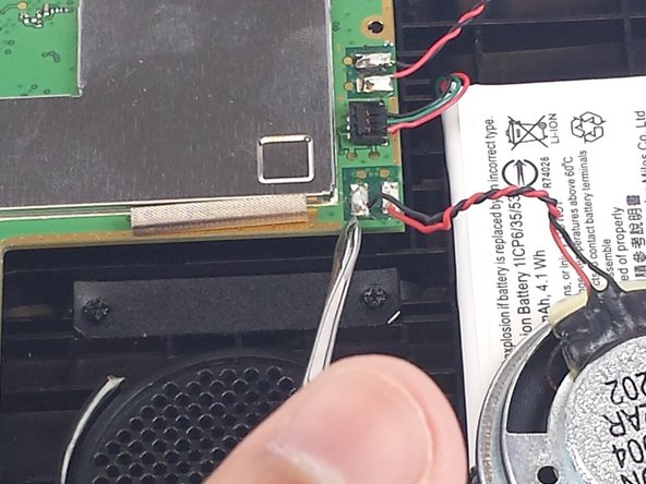

  5. Garmin Dezl 770LMT Speaker Replacement: crwdns2935265:05crwdnd2935265:01crwdnd2935265:02crwdne2935265:0 Garmin Dezl 770LMT Speaker Replacement: crwdns2935265:05crwdnd2935265:02crwdnd2935265:02crwdne2935265:0
    Anti-Static Wrist Strap
    $7.95
    • Grasp the wire connecting the motherboard and pull the wares connecting it.
    • Remember to wear an anti-static wrist strap when handling the motherboard.
