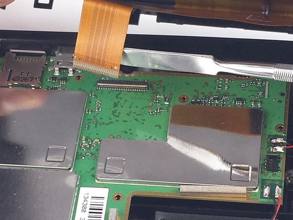

    • After you've removed the back cover, you will see a copper colored ribbon connected to a grey hinge.
    • Carefully remove the hinge from the cord using a spudger and the ribbon will come out.
    • The regular black nylon spudger should be used whenever possible, especially around sensitive internal components.
    • Make sure to wear an anti-static wrist strap when handling the motherboard.

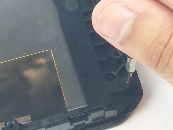

    • Now you have the screen, which is enclosed by another cover. Remove the eight screws that hold it in place.

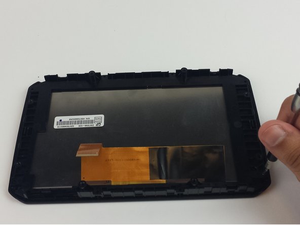

  6. Garmin Dezl 770LMT Screen Replacement: crwdns2935265:06crwdnd2935265:01crwdnd2935265:01crwdne2935265:0
    • Once the screws have been taken out, use a spudger to carefully remove the cover. With this cover removed, the screen is now completely exposed.
