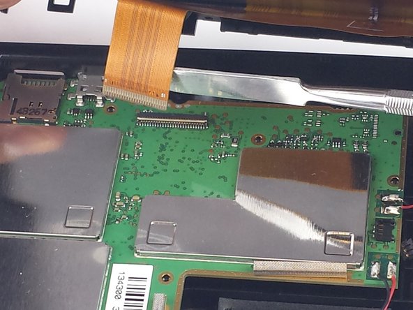

  4. Garmin Dezl 770LMT Motherboard Replacement, Motherboard: crwdns2935265:04crwdnd2935265:01crwdnd2935265:02crwdne2935265:0 Garmin Dezl 770LMT Motherboard Replacement, Motherboard: crwdns2935265:04crwdnd2935265:02crwdnd2935265:02crwdne2935265:0
    Anti-Static Wrist Strap
    $7.95
    • After you've removed the back cover, you will see a copper colored ribbon connected to a grey hinge.
    • Carefully remove the hinge from the cord using a spudger and the ribbon will come out.
    • The regular black nylon spudger should be used whenever possible, especially around sensitive internal components.
    • Make sure to wear an anti-static wrist strap when handling the motherboard.
