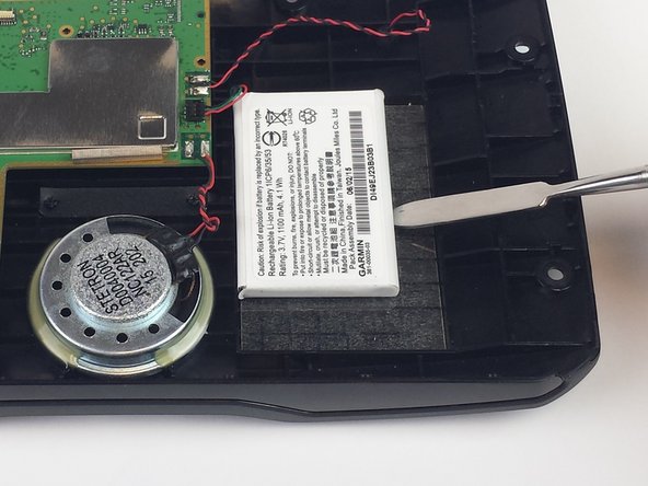

  4. Garmin Dezl 770LMT Battery Replacement, Battery Replacement: crwdns2935265:04crwdnd2935265:01crwdnd2935265:03crwdne2935265:0 Garmin Dezl 770LMT Battery Replacement, Battery Replacement: crwdns2935265:04crwdnd2935265:02crwdnd2935265:03crwdne2935265:0 Garmin Dezl 770LMT Battery Replacement, Battery Replacement: crwdns2935265:04crwdnd2935265:03crwdnd2935265:03crwdne2935265:0
    • Using a metal spudger, carefully pry the battery from the device.
    • The regular black nylon spudger should be used whenever possible, especially around batteries.
    • Before you place the battery back in, make sure to place some double-sided electrical tape to attach it to the case.
  5. Garmin Dezl 770LMT Battery Replacement: crwdns2935265:05crwdnd2935265:01crwdnd2935265:02crwdne2935265:0 Garmin Dezl 770LMT Battery Replacement: crwdns2935265:05crwdnd2935265:02crwdnd2935265:02crwdne2935265:0
    • Grasp the wire near the mother board and gently lift to detach the battery.
