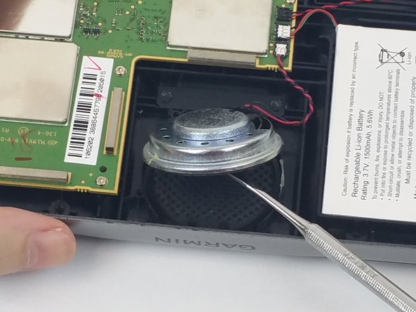

  4. Garmin Dezl 760LMT Speaker Replacement, Speaker: crwdns2935265:04crwdnd2935265:01crwdnd2935265:02crwdne2935265:0 Garmin Dezl 760LMT Speaker Replacement, Speaker: crwdns2935265:04crwdnd2935265:02crwdnd2935265:02crwdne2935265:0
    • Using the sharp end of the metal probe, scrape away the wax around the base of the speaker.
    • Slide the metal probe underneath the speaker and pry upwards.
    • During reassembly, use electrical tape to hold the speaker into place.

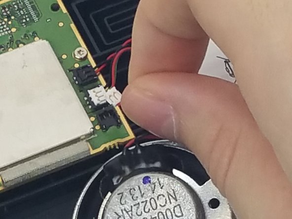

  5. Garmin Dezl 760LMT Speaker Replacement: crwdns2935265:05crwdnd2935265:01crwdnd2935265:02crwdne2935265:0 Garmin Dezl 760LMT Speaker Replacement: crwdns2935265:05crwdnd2935265:02crwdnd2935265:02crwdne2935265:0
    • Grasp the speaker wire near the motherboard and lift upward to detach the connector.
