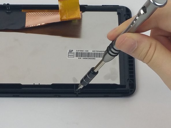

    • Using a Torx T5 screwdriver, unscrew the four 7mm screws from the back plate of the screen.

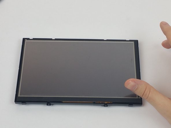

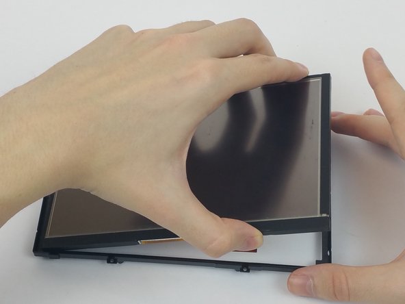

    • Turn the screen over so that it is facing upwards.
    • Remove the front plate of the screen.
    • Lift the screen from its back casing.

where can one by the replacement screen
tempestrogue - crwdns2934203:0crwdne2934203:0
Ebay sells these screens replacement - search online for “ZD070NA-03K “ or on google, even amazon sometimes has them. Its a hard to find screen so you will probably only get it from hong kong or china.
